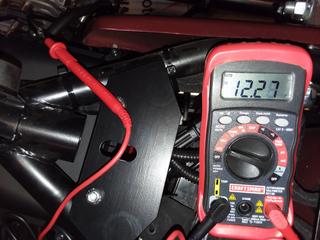

Have you put a multimeter on it to see if/when it's "hot"?
jaybird wrote:
Wed Feb 27, 2019 7:22 am
The fuse/feed for the spotlight used to be in that location, IIRC it was live all the time.
Thanks for the feedback.
Via a multi-meter, I confirmed that the terminal supplies switched 12V power. It's a thin gauge wire, blue w/red stripe.
Included in my 2018 Owner's Manual is a lo-res wiring diagram for the 2017 model year Urals. I can just make out a blue/red wire on that diagram; it supplies power to both tail lights...which I just tested for correct function on my GU with the Ignition on. Pass.
Perhaps this is a "free" (unused) terminal, so to speak. My Suzuki has two of them. I just want to be sure here.
