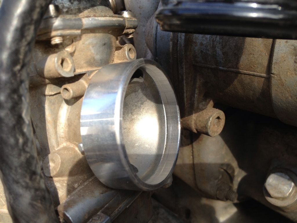

Post by BinDerSmokDat » Mon May 06, 2013 1:21 pm
Mine slipped on tightly and then a few gentle taps with a soft faced hammer and a block of wood.

Post by bauerhillboy » Wed May 08, 2013 6:40 am
After absorbing everyone's response to my q, last night I took a small file and smoothed out any little rough spots on the carb flanges. Then I used the end of the plastic handle on a Craftsman screwdriver to tap gently around and around on the ring till it was on all the way. Very easy job and took 10 minutes.

Post by Ponch » Wed May 08, 2013 11:13 pm
I heated the rings with my wife's hair dryer (when she wasn't looking :P ), and just had to tap them slightly with a small rubber mallet.

Post by SmellyGoatBoy » Thu May 09, 2013 6:59 pm
I still haven't received my order from Raceway so I called them. There was some sort of mix up and they did not ship my order. They are fixing it now, and I have to wait longer. I did buy a heat gun yesterday, so I'm already to install them when they arrive (and the new headlight too). I have to keep repeating to myself, "Patience...Patience...Patience..."

Post by Underhill » Fri May 10, 2013 9:39 am
BinDerSmokDat wrote:Mine slipped on tightly and then a few gentle taps with a soft faced hammer and a block of wood.
Wow! That looks nice. I made mine out of soup can tin. Works a treat. :feelsgood:

Post by joeski3 » Mon May 13, 2013 3:45 pm
Rings came today, took all of 15 min to do both sides. Fit like a glove.

Post by SmellyGoatBoy » Sun May 19, 2013 2:01 am
Perch rings slipped right on with a few taps with the back of a screwdriver. Super easy. And worked just fine with the new branch pipes. Total time to install about 10 minutes, and only one tool. Standard screw driver.
