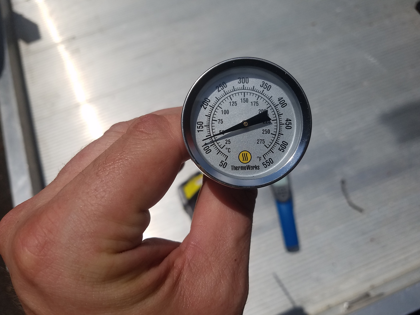

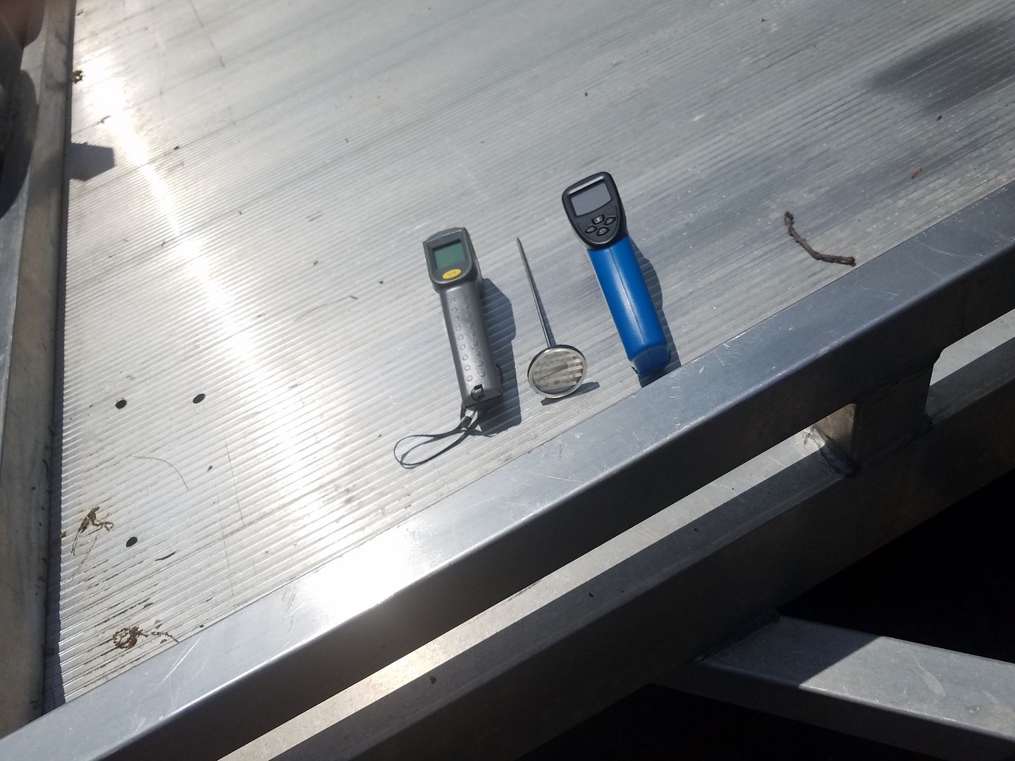

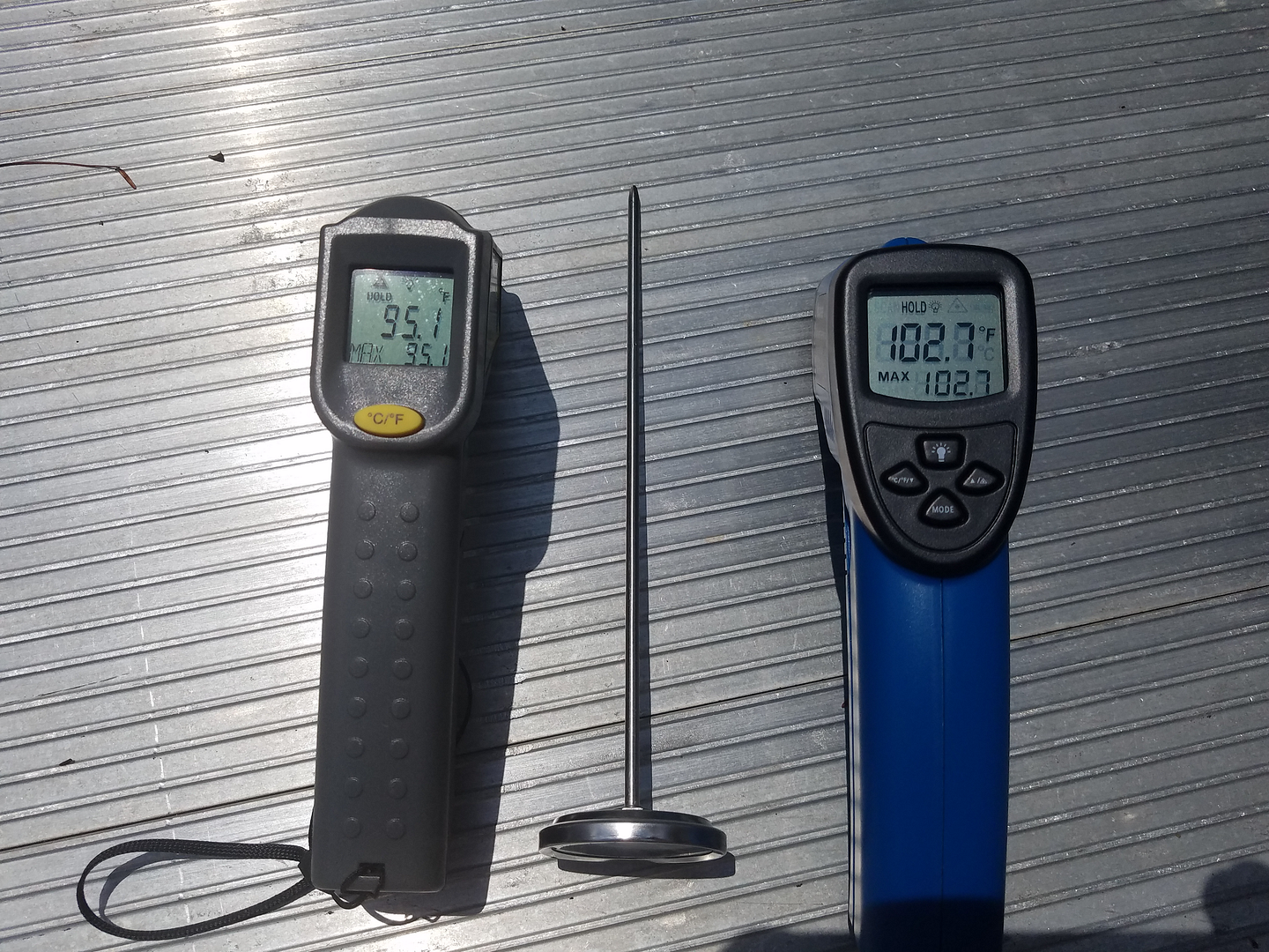

Case in point, just did this test...
From left to right...Centech Laser IR from Harbor Freight, Thermoworks dial (same as link above) and Nubee Laser IR.
The Nubee is slightly better than the HF one and alows for entering the emissivity of the surface being measured.
Still a pretty cheap IR thermometer, I bought it before COVID sent the prices of these things through the roof because everyone wanted to check forehead temps...which they are HORRIBLY inaccurate for but I digress.
I left the dial thermometer on the aluminum trailer in the sun until the reading stabilized and then measured with both laser thermometers.
The cheap HF read 95.1F the Nubee read 102.7F
And the dial thermometer read...
120F!
I checked that thermometer in an ice bath (32F) and in boiling water (212F) when it arrived, so I know it is calibrated and accurate.
Also the "palm of my hand test" told me that the trailer was significantly hotter than 95F.
So this goes to show you, take IR thermometer temps as a comparative tool, (it's hotter here than there) not as an accurate measurement.
