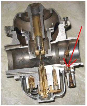

Pic of this particular Bing cross section.

Looking at your cross section, it would appear that the idle mixture is a fuel screw and not an air screw. I say that because the passage from the jet goes to the screw rather that into the throat of the carb. But I also see a small air passage going toward the screw. Your drawn in arrow obliterates the detail. However, the Bing info I could find on-line says it is an air screw. But that may not be info applicable to your carbs. A lot of the Bing info on line is for Rotax engines in aircraft. I've never had to monkey with the Bings on my R100/7 so cannot be sure which it is.
Your info says the idle mixture is out 4 turns, which is way too much. If it is an air screw, that would make it lean. Bringing it closer to 1-1/2 turns would richen it up. If it is a fuel screw, then four turns out says the jet is too small. But I suspect that at 4 turns, the screw has stopped having an effect and the size of the pilot is controlling the mixture.

Judging by the video just posted here, Idle mixture screw does more than increase the fuel bypass trough the pilot jet?
At this point I'm a bit contradicted now, some say that pilot jet and screw is all about 1/4 of the throttle(is it cruising speed), but judging by the video, it's all about the idle?

Harijsk wrote: Judging by the video just posted here, Idle mixture screw does more than increase the fuel bypass trough the pilot jet?
True, it's fuel & air mixed.
Not as cut & dried as that, there's a large amount of overlap between what the idle & main jets do.
