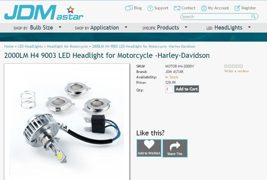

Nybigdog82162 wrote:didn't mean to stir the UNE pot, I actually have been there personally myself, nice set-up & plenty of stuff in stock...bought many things from them on-line. I agree higher prices, but they stock a bunch of stuff.
Just looking to see if anyone had converted headlight to an LED set-up...
Think this is the same bulb???
It will "probably " work. The extra metal rings are to be able to fit the bulb in different configuration housings, like H11, H4, etc. When I mention that a bulb like HID has only 1/4" room/space before the end of the headlight bucket, that is a critical measurement. Also, it is critical as to the orientation of the bulb - like on a clock face. One LED face needs to be at 6 to be the high beam for the lower reflector. It could be the other way around at 12, with 2 diagonals pointing to a high beam reflector. Some LED bulbs do not do this properly, so it screws up the light pattern and dispersion. (photo added)
The LED bulb has a big fat diameter fan on the end and the bucket gets narrower and narrower towards the end. Will this fit without touching the bucket? I do not know. If it fits, then how much do you have to crunch the wires to get the 3-prong connectors together? I took the 3-prong connector apart and reassembled it behind the headlight bucket to make it easier on the wires and for space. You can not push the 3-prong connector through the hole in the back of the bucket unless you take it apart and reassemble.
It is just something to think about when putting really new technology into a 70 year old design machine.
