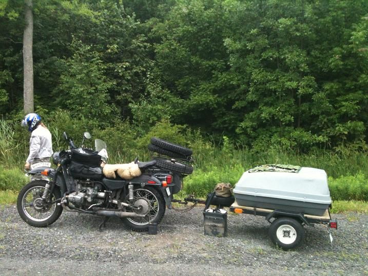

I have pulled a trailer on quite a few trips, some covering 2000+km round trip. A small framed (3x4) trailer and a car top luggage box bought used work great. On my 07 the trailer harness was already there, so I just needed a modular(?) unit for the brakes/signals. Make sure your brakes are adjusted properly and you will be fine.

berger wrote:I have pulled a trailer on quite a few trips, some covering 2000+km round trip. A small framed (3x4) trailer and a car top luggage box bought used work great. On my 07 the trailer harness was already there, so I just needed a modular(?) unit for the brakes/signals. Make sure your brakes are adjusted properly and you will be fine.
This is one of the coolest rigs I have seen in a while.
Great way to go around and still have plenty of "stuff" to haul behind.
