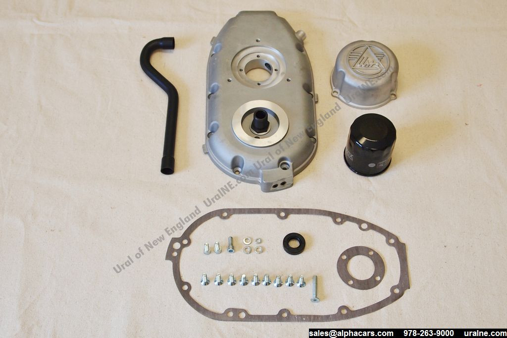

Here's Urals spin on filter conversion kit, https://www.uralne.com/engine-front-con ... il-filter/
Straight up swap of front cover, pretty easy to do. Available from any dealer.
