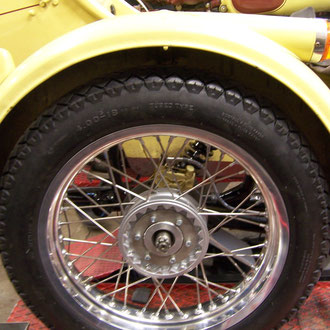

Uli Jacken, a German Ural dealer links the front and sidecar brakes. (https://www.uli-jacken.de/home.html#)
Just wondering what the reason for this is and if it actually has some advantage or not.
Picture from the website. He does this modification on all Urals he sells and probably also on the custom rigs

In theory, I guess it would help you brake in a straighter line - if you’re only using the front and not the peddle (pusher) brake. But since the Sidecar is so light weight and it’s breaking assistance is minimal at best, I’m not sure it would be that effective. With-that-said, it can’t hurt (except in your wallet)

The reason is to brake in a straighter line like Lokiboy wrote. The Ural rig brakes quite well with it´s disc rotor brake on the front wheel, but if you panic and hit the front brake, the wheel locks up and the side car pushes you directly into the oncoming traffic. To prevent that, this type of brake linkage is quite good. if you hit the front brake, the side car brake will work together with it and beeing pushed to the left hand side is not very likely.
If I build a rig, I always take care to link either the front or the rear wheel to the side car wheel. Or both. On my Suzuki rig the foot brake engages the rear wheel caliper, one 4 piston caliper on the front wheel and one 2 piston caliper on the hack. The front wheel engages the second 4 piston caliper on the front wheel and the second 2 piston caliper on the hack. This means an absolute straight line when braking in panic. In worst case with three blocked wheels. A great advantage over a front wheel with two original calipers only, engaged with the front brake master.
Quite a good number of customers´rigs end up in my shop because of blocking the front wheel and sliding into the bushes during the first couple of weeks of ownership.

You´re right. There is no reasonable way to link the drum brake on the hack to the disc brake on the front wheel on older Urals.
Once you convert it to disc brake (like I do 3 or 4 times a year), you would link it to the front brake. (some link it to the rear drum brake with an additional foot brake master on the hack´s frame, but I don´t like that version.

This is a good point when linking the original side car brake to the front brake, and I didn´t think about it, because I most of times build my own side car brake with a smaller scooter disc rotor. This prevents from overbraking the side car wheel.
