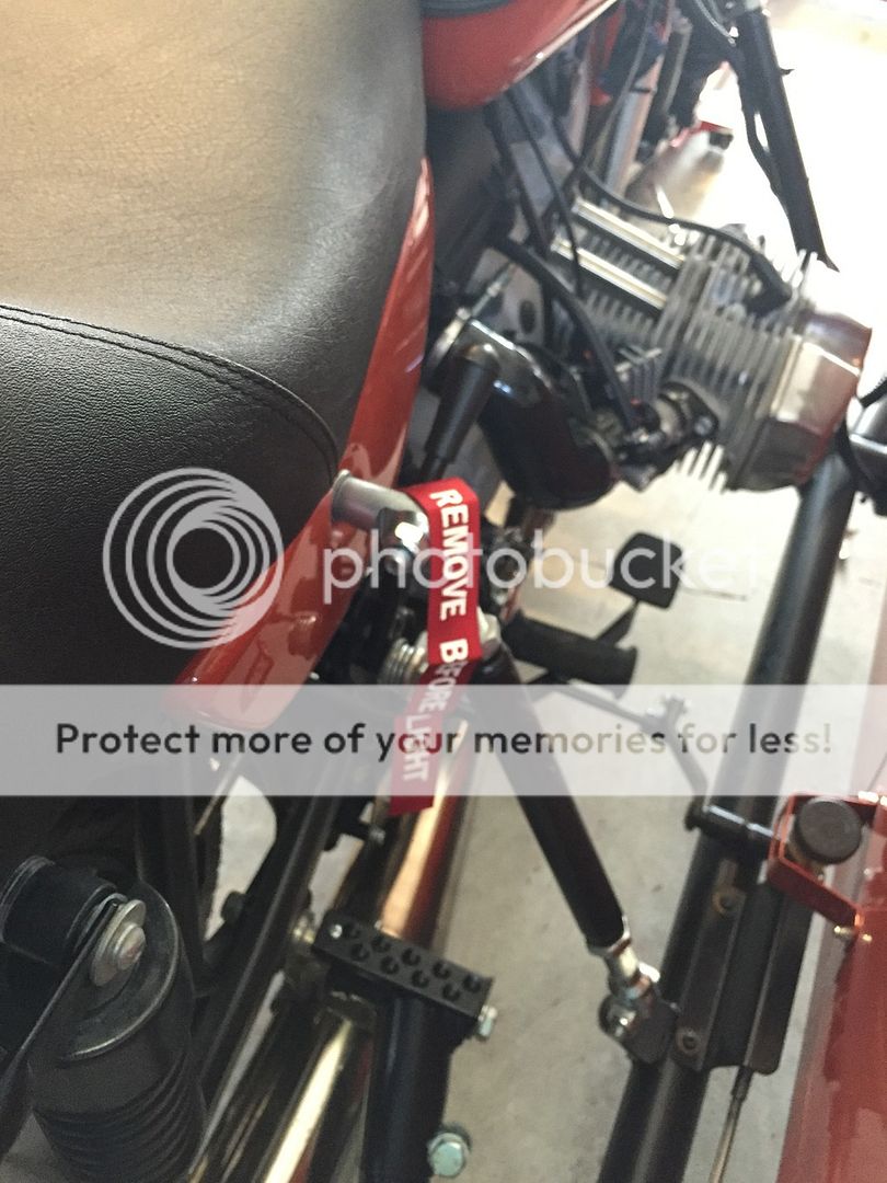

Added this to the brake. Hoping I'll remember to release it.... without adding some complex system..
