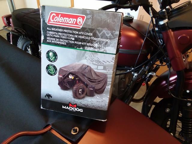

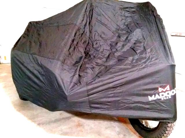

N.B.: The MadDog/Coleman brand ATV cover is a confirmed fit on my Gear Up.
Link: https://smile.amazon.com/gp/product/B00 ... UTF8&psc=1
OEM mirrors in situ, no windscreens.
The installed cover is snug, but there isn't any excessive strain.
This is the second time I've mentioned the cover here. :wink:

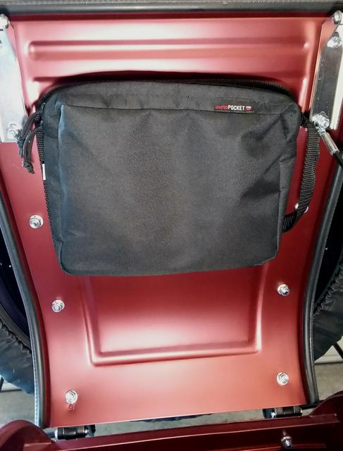

I installed a Moto Pocket top case bag in the rig's trunk.
'Twas previously used in the top case of another motorcycle, now sold.
Ordered another sheet of high-strength 3M adhesive Velcro for the Ural install.
Link: https://adventurepockets.com/product/mo ... case-11x9/

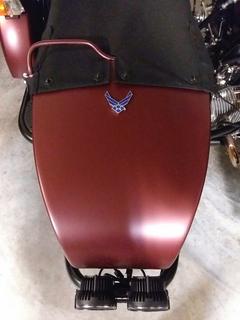

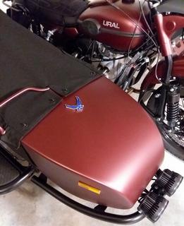

Next: I'm deciding where to install a cast (i.e., inflexible) USAF emblem. The adhesive requires an absolutely flat surface, of which there is not a surfeit on a Ural. Help me decide.
Option A: Top center of sidecar
Option B: Front side of sidecar
Vote now. :)
I bought a MadDog for my project bike, but lately I've been using it on the Mobile Chernobyl in place of my fitted Ural of New England cover. It's a little looser, so it's a little easier to install and remove. Mine appears to be made of a different material that the one pictured; more canvas-like. It doesn't wrinkle like the the one above. Also, the black faded to a gray on top, but it still repels water.
Is that a challenge coin?
If the only two options are the locations shown, I prefer the hack side.

+1 on the hack side
