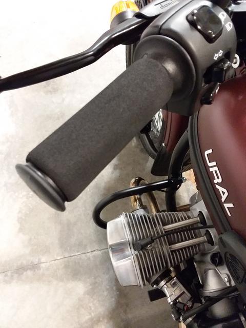

Installed Grab On grip covers. Confirmed that they don't foul proper operation of the clutch lever.

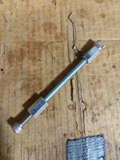

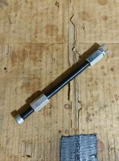

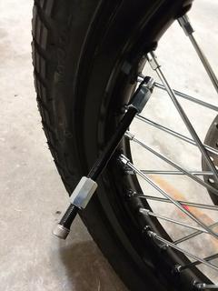

Next, I went to the hardware store to configure a handle for my 6.8mm spoke wrench. The handle that came with the wrench kit is used for the spoke wrench that fits on the Suzuki's spokes. It is stored in that particular tool kit.
The thread pitch on the spoke wrench is M8x1.25. The matching all-thread rods were just 100mm; too short for my liking. I used a second coupling nut and a stainless hex socket head bolt to create the desired handle length and feel. Assembled with blue thread lock and wrapped with Scotch 33+ electrical tape. A snug but correct fit on the Ural's spokes.

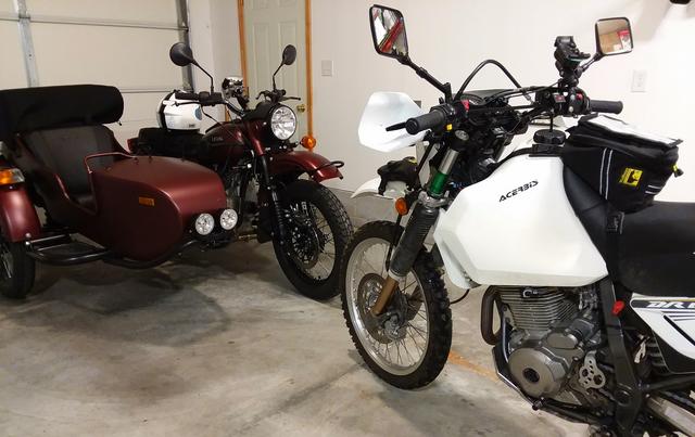

Moving right along, I introduced the Suzuki to her new stablemate.
