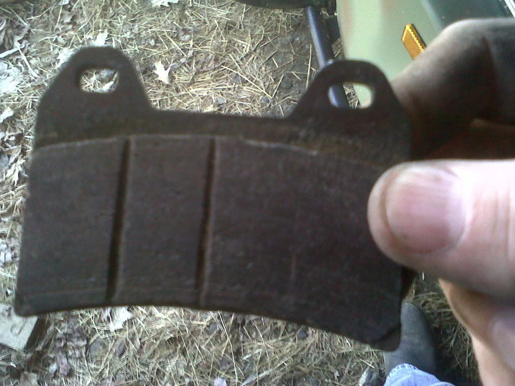

Yesterdays ride was great but I noticed the front brakes were weaker than they should be so since I was doing an oil change today I figured I'd pull the pads and see how they looked. I figured they were gummed up since that has been the case in the past.
Well upon pulling them out and giving them a quick squirt of brake cleaner this is what they looked like.
Crap that doesn't look right at all they aren't wearing evenly. :( Time to dig a bit deeper (I figured I had a piston that might be a bit sticky so time to check that out. Well as I was about to do that I noticed that the caliper wasn't centered over the disk but was canted a bit pointing the front of the caliper toward the hack nose. Well this would explain the uneven wear but WTF???

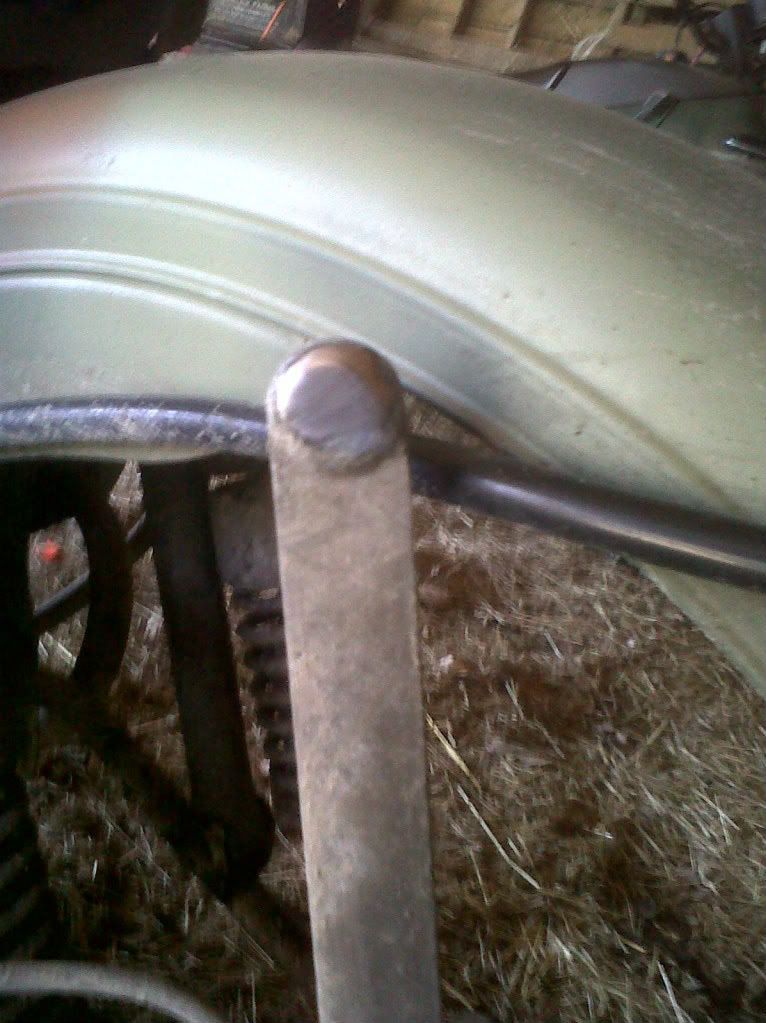

Checking the arm that hangs it from the back of the leading ilnk no obvious bends but it looked really weird where the bushing is. The nut was sucked inside the mounting hole and thus the arm had slipped toward the tire by about 3/8". :? This is strange as I know it's tight.
I could just get on the nut to loosen it up with a thin walled 17mm deep well socket and took the whole contraption apart figuring the bushing was shot.
When I took it off I found out what had kept it from completely falling out.
That picture is the back side of the connecting arm and the smooth round spot at the end was polished by the side of the front tire.

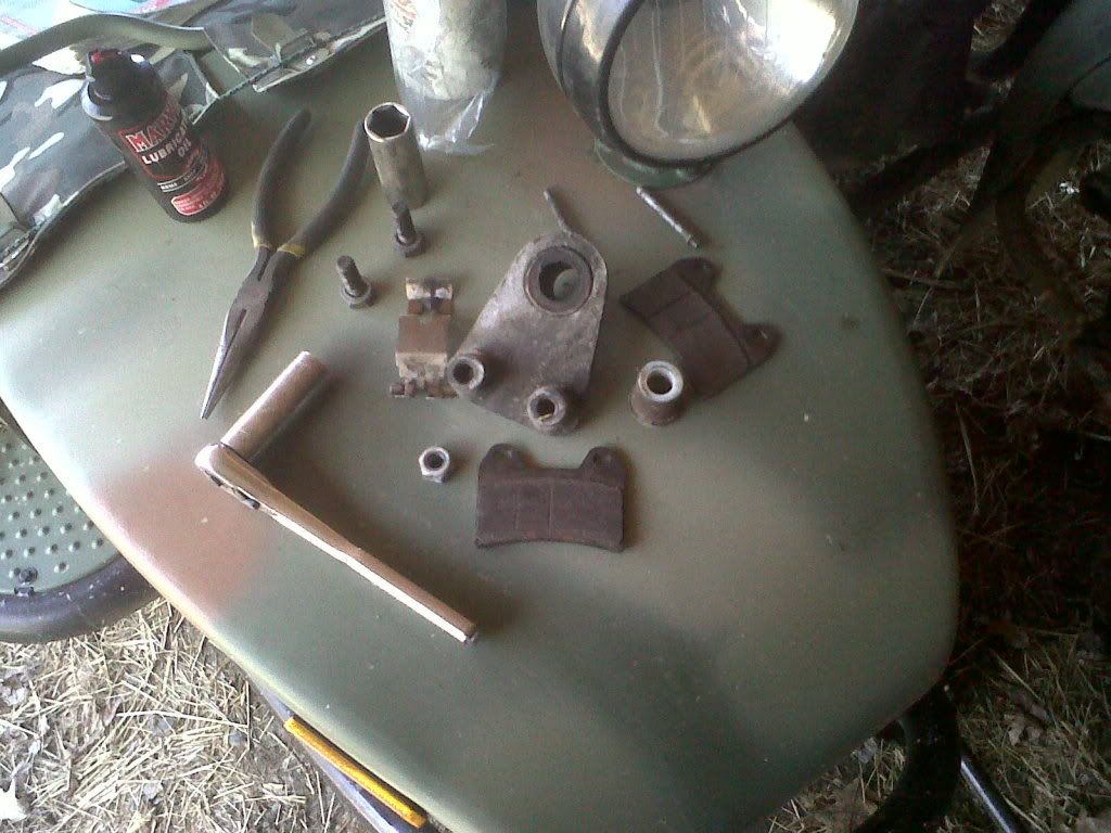

Here is the bushing

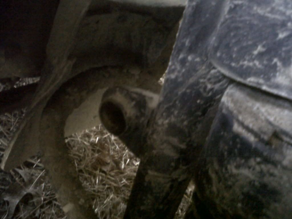

and here is the hole in the front end where it's supposed to go.
Well the bushing wasn't great but was far from shot so my solution was to put it back in there add a washer the same size as the bushing to get a few more threads to tighten it down and then to add a slightly over-sized washer to keep it from backing out of the front end and tighten it down with the lock nut.

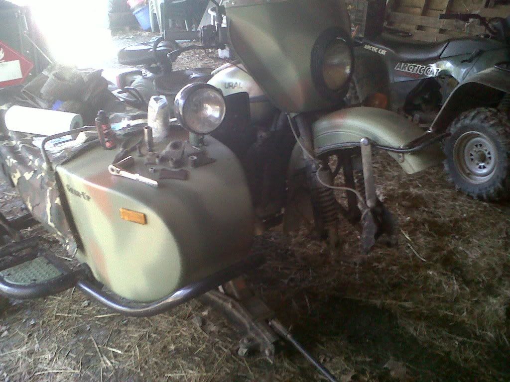

She looks so sad when she's in pieces... :cry:
At least these biked come with a handy place for tools and parts.
