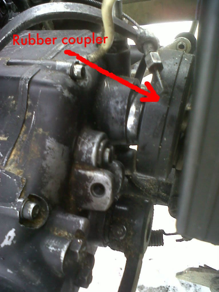

I wonder if you have fallen victim of the hockey puck from hell syndrome. Seems like a bunch of the newer rigs have chewed the rubber coupler up. The picture below gives a good view of it in the center just keep in mind that a bunch of crap has been removed from the area including the clutch actuator rod. Check the rubber coupler between the output shaft and the drive shaft to see if it's been chewed up causing the output shaft to spin and clunk into the drive shaft but not turn the drive shaft. The fix for that is to get the older rubber style coupler like Gobium just had up for sale. Either that or you got the gear box stuck in a false neutral between 2nd and 3rd or 3rd and 4th. If the donut is good try rocking it back and forth and try to downshift or upshift the heal toe lever to see if it will fully engage into a gear.

After I had it towed, we looked at it again, the drive shaft at the gear box clunks and seems to be (for a lack of better terms) skipping or a pop as it makes a full rotation.
